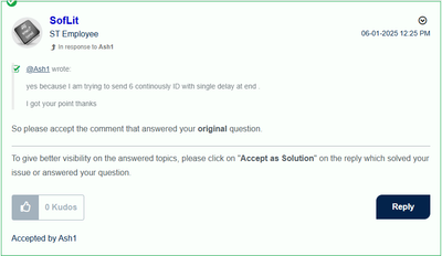

2025-01-06 3:25 AM
@Ash1 wrote:
yes because I am trying to send 6 continously ID with single delay at end .
I got your point thanks
So please accept the comment that answered your original question.
2025-01-06 3:45 AM
You accepted the wrong comment:
I will mark the nearest comment that answered your question as "Accepted as Solution".
