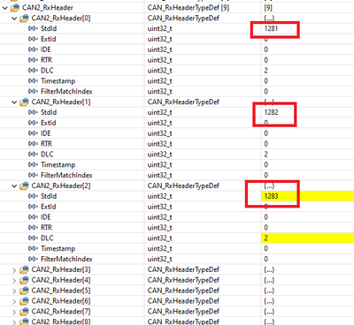

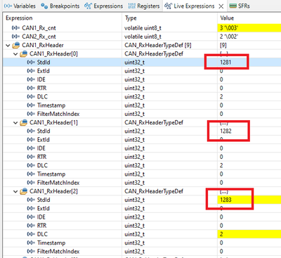

I've created a simple project where CAN1 and CAN2 are in loopback mode using STM32F407 Discovery board and I'm receiving well all the sent IDs: 0x502 (1281), 0x502 (1282), 0x503 (1283) on both sides CAN1 and CAN2:
CAN1 Rx:
CAN2 Rx:
I've attached the project.
