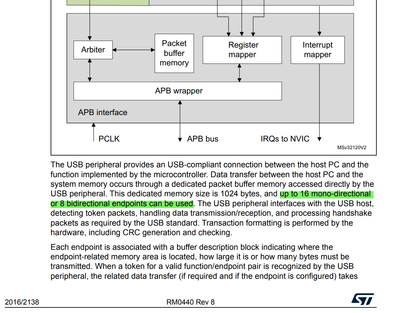

2024-07-01 6:10 AM - edited 2024-07-01 6:11 AM
Indeed @gbm Sorry my bad @BarryWhit , 8 bidirectional endpoints.
Each unidirectional endpoint can be configured as IN or OUT (Means total 16 uni EP = 8 IN +8 OUT, including the control IN/OUT endpoint). Each of the 8 bidirectional endpoints can be configured either as control, interrupt, bulk or isochronous.
