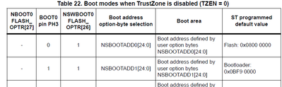

1. Pulled PH3-BOOT0 pin high to boot from bootloader

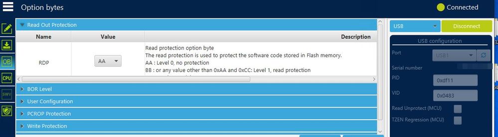

If you can connect to your board with STM32CubeProgrammer, it has a dedicated screen for modifying options bytes. Reset the RDP option byte to level 0, wait for the chip to fully erase, and you should be ok.
If you can't connect over ST-Link, all may not be lost. All STM32 chips by default have a built-in bootloader (See AN2606 for details). You can try to activate this built-in STM32 bootloader. STM32CubeProgrammer can then connect to the board over USB or UART, and modify the Option Byte over that connection.

3. Get into bootloader mode. If you have such buttons (most eval boards do), you do this by holding nRST+BOOT0 buttons, and then releasing the nRST button, wait a moment, then release the BOOT0 button. You should now be in bootloader mode, and the board should show up on your system as a USB-DFU device.
4. Open STM32CubeProgrammer. Connect to the board by seting the connection type to "USB" and clicking connect.
5. Once connected, go to the "OB" pane (The "Option Bytes" pane), and reset the RDP option byte to level 0.
Wait until the process completes.
6. Your board should now be functional again.

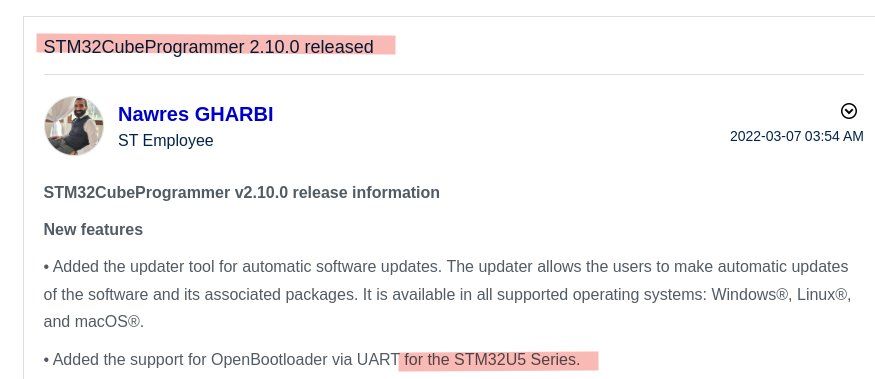

2024-06-28 10:42 PM
v2.10 is little old for U5
2024-06-29 2:41 AM
but is supported.

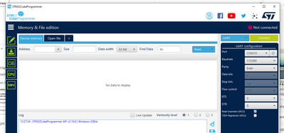

2. Connected to my target board using UART interface as follows
3. Followed steps mentioned in forum to disable Security Zone (TZONE)
Security:How to disable TrustZone in STM32L5xx devices during development phase - stm32mcu
