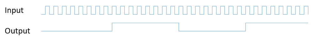

Is it possible to configure 1 or more timers to divide incomming pulses on a pin by a factor (for example 8) and send out the result on another pin?
Like this:
That way I would not need to implement the counter in software.

This should be possible with the timers, e.g. with the function Output Compare Toggle. Details can be found in AN4013 or in the respective reference manual, section Output compare mode.
Regards
/Peter
