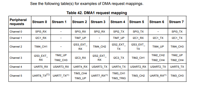

Using an STM32F429 board, I am attempting to enable DMA transfers for the UART8 TX and RX. However, while reading the data sheet, I found the following DMA channel/stream mapping:

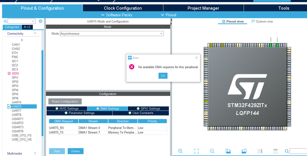

You'll note that for the UART8 TX and RX DMA request, both requests live in the same channel, but different requests. When I attempt configure both the TX and RX request in Cube, I get the following error a second DMA request addition is not allowed for the peripheral. Can the STM32F4 MCU's not handle the same DMA request channel being mapped to one peripheral? And if so, can the DMAMUX be used to get around it?

Channel and Stream naming is confusing. The STREAM is the unique DMA sub-unit.
Each stream has multiple channel sources (input mux, trigger), CH5 STREAM 0 being mapped UART8_TX ie UART8->SR.TXNE

UART5 or UART8 ?? Screen shows one, you talk about the other.
UART5_RX can't coexist with UART8_TX. Unfortunately that's just going to be a limitation. Technically the resource could be managed and shared, but likely me trouble than it's worth.

You can only assign one channel to a given stream. So Steam 0 can either be UART5_RX or UART8_TX, but not both. No way to get around that hardware limitation. Choose a different UART.
There is no issue assigning the same channel to multiple streams, but it doesn't help you here.

There is no conflict between UART8_RX and UART8_TX. Why would disable one to run the other one?
The DMA has 8 streams. Each stream can only do one thing (channel) at once.
2022-02-25 6:21 PM
The conflict is on stream 0 which can either be set to UART5_RX or UART8_TX, but not both.
