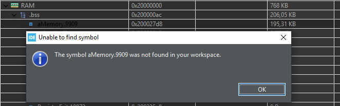

This just lacks any context.
Is this coming from a library?
Perhaps grep within your workspace or the libraries/files it touches.
Perhaps look for "aMemory" rather than the fully qualified name.
Perhaps look at the .MAP file

Came from a library which occupied some RAM. Segger emWin lib with "#define GUI_NUMBYTES" i was able to adjust it.
