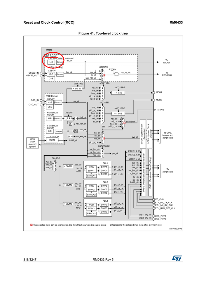

The H7 errata and clock tree indicates the LSI is in the backup domain but the top of page 351 it says it is not:

> The H7 [errata and] clock tree indicates the LSI is in the backup domain
I see something different:
I don't see any such indication in the errata either.

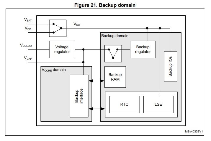

You are right Figure 39 RCC Block diagram shows the LSI in the VDD domain.
But Figure 17 Power supply overview shows LSI in the backup domain.
2019-07-23 7:52 AM
Fair point, indeed there it is.
@Imen DAHMEN , @Amel NASRI , can you please clarify whether LSI is in VBAT/backup domain or in VDD domain, in STM32H7? One of those Fig.17 and Fig.39 must be wrong.
2019-08-14 8:12 AM
Thanks for bringing this typo to our attention. We confirm the contradiction, we are fixing this for next release of the reference manual.
So, we will correct Figure 17. Power supply overview: LSI needs to be moved from the backup domain to the VDD domain.
The best way to clock the RTC during a VDD power loss is to use the LSE as both LSI and HSE are off.
