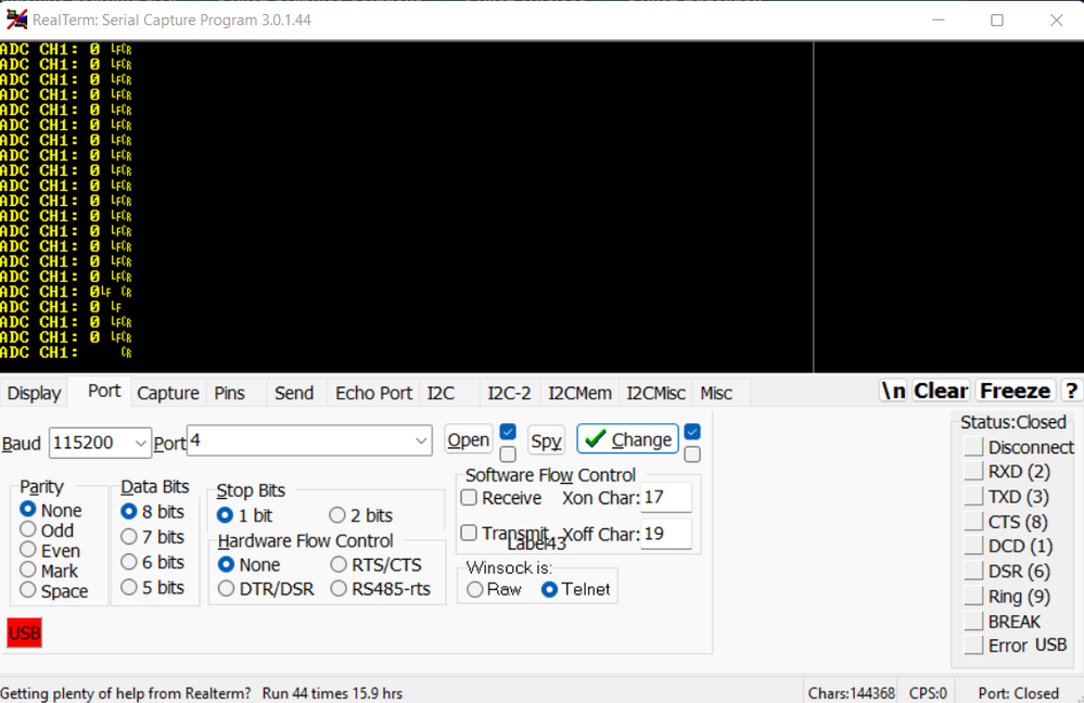

I have an STM32G474RE, I have not used any HAL or LL libraries, I have only programmed using the registers, my issue is that I am only getting 0 on the output of the ADC, I read through the reference manual and still couldn't solve the problem. I have used ADC channel 1 and PA0 pin since that is what was written in the manual. The output from the UART is shown below.

I used the stk link debugger, however since there is some issue with my live expressions, I use the UART to display values
