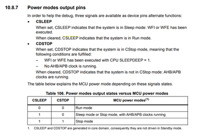

another Tips in trying to visualize the signals CSLEEP and CSTOP pins to know the state of your device and if it really entered a stop mode.
here is the snippet describing the state of this pins from STM32H523/33xx, STM32H562/63xx, and STM32H573xx Arm<Sup>®</Sup>-based 32-bit MCUs - Reference manual
