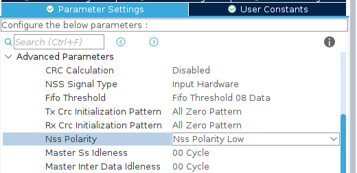

So the CPOL & CPHA on both master SPI devices that I'm working with are the same (1 & 1), but for some reason the new master device has an ACTIVE HIGH chip select, whereas I am used to the standard active low default.
So now my question becomes:
How do I update my MxCube settings to accept an Active High chip select?
2022-12-09 4:15 AM
just set nss pol. hi ->
or, if you cannot nns hardware pol. , put just a simple inverting gate in the line to cpu nss and is "low" select again.
2022-12-09 7:44 AM
Changing the NSS polarity isn't an option on this device apparently. I'll have to figure out how to invert the signal before it hits the MCU. Thanks for the help!
