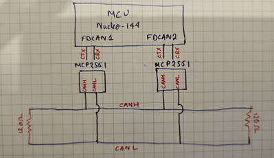

I am trying to communicate CAN. I am using two boards Nucleo-G474RE and Nucleo-H755ZI-Q and two MCP2551 as transceiver.
On either side, program works for External loop back configuration. ( I did step by step debug to ensure the transmitting data is getting received or not).
But I am not getting the interrupt when in normal mode. I also tried using a single board with shorting tx and rx of the transceiver and also using two boards.
What might be the issue?
I have only attached the IOC file and main.c file for Nucleo-H755ZI-Q and it is similar for Nucleo-G474RE also.

You only show TX/RX connected to the MCP2551.
Is the MCP2551 VDD connected to 5V and VSS connected to ground? Is the Rs pin connected to ground as well?

Yes, since MCP2551 powering connections are obvious I didn't mention in the connection drawing.
VCC is connected to 5V and GND pins are shorted along with the board GND.
You did mention about Rs pin: There is no Rs pin ; is it a typo for 'Rx' - if yes then I didnt connect it to the ground
2025-01-12 11:07 AM
The MCP2551 does indeed have an Rs pin. You didn't mention that you are using a custom PCB board with the MCP2551 on it. If you look at the schematic for that PCB board, the Rs pin is grounded.
The next step is to get a oscilloscope to see if you are getting CAN bus messages transmitted. Then you can determine if it's an Rx or Tx issue.

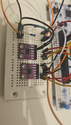

2- And this transceiver pin needs to be pulled to the ground:
I see from your screen shot you are using shields but better to double check with a multimeter (in continuity mode with transceivers are powered off).
