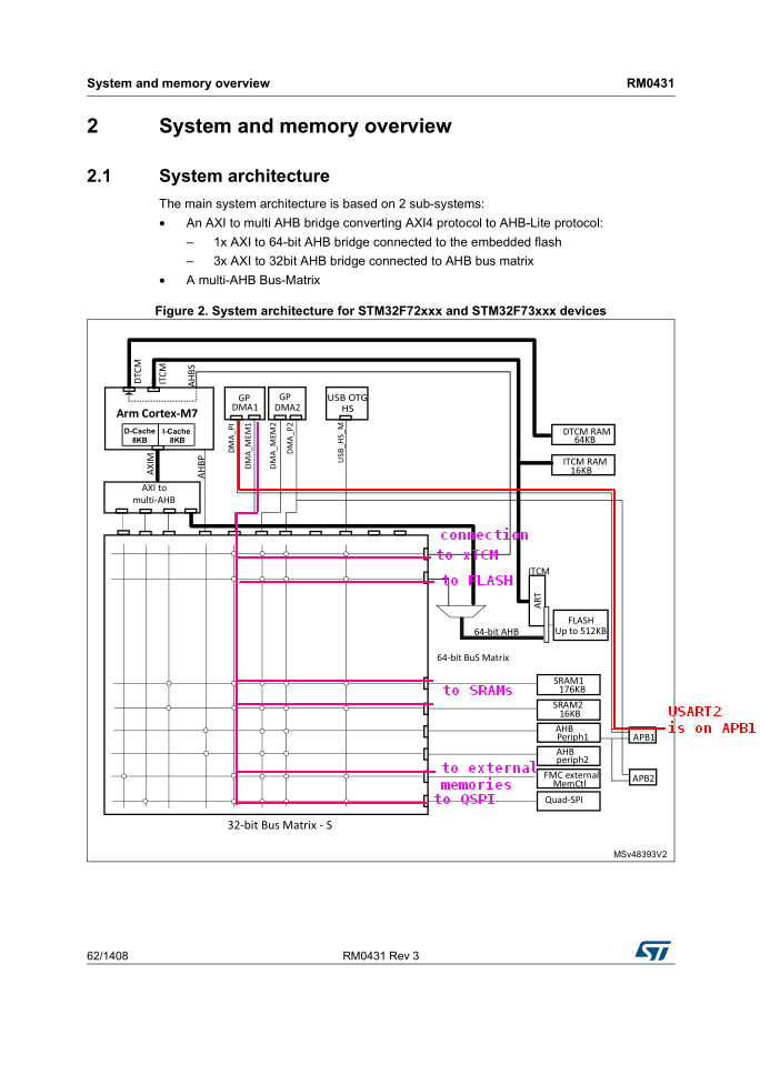

Yes you can use DMA1 to access USART2, which is on APB1:

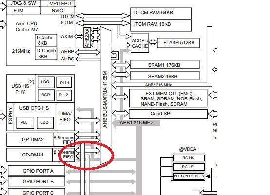

2022-12-18 6:19 AM
The place, you encircled, literally shows that the DMA1 is also connected to the same AHB bus matrix.
2022-12-18 11:01 AM
Whilst it is not true on all STM, the STM32F2/4/7 the DMA1 associates with APB1, and the "Peripherals" on that bus, and DMA2 to APB2. But here DMA2 also supports Memory-to-Memory which has broader reach, but also involves more bus cycles/sequencing to "load-then-store" across different or conflicting paths, whereas others more direct/local actions can be done in a "feed-thru".
Also peripherals on APB1 can trigger action on DMA1, like UART or TIM
By localizing traffic you can avoid conflicting, and slowing, other usage, most especially code execution
