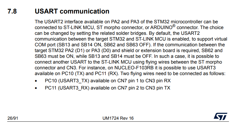

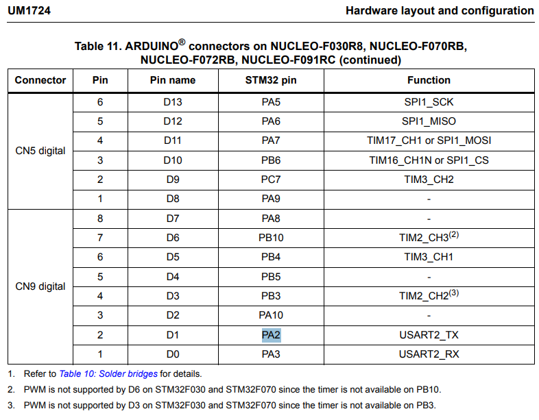

You can confirm that in the board's User Manual:

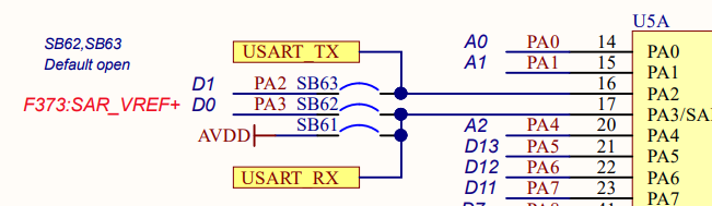

You could also check the schematics:

OK so the board is set up correctly for use of USART2 over the ST-Link/USB connection, I have used this before with no issue with the board but just double checked & it all looks good.
