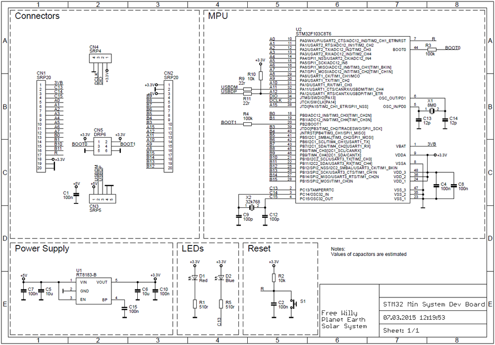

>missing pull-ups
no. see blue pill circuit... you have some other problem . something like boot0/1 floating...
only pullup on reset and R10, on usb Dp ; (and thats wrong :)) 10k -> 1k5 would be correct.

The bootloader strategy has changed in the STM32F30xx and BOOT1 is not necessary anymore. The boot memory (RAM, Flash or System memory) is selectable through an option bit.
BOOT0 is connected to ground.
I will continue to search for the error.

i have no idea, whats wrong on your board.
but..touching, and it works. -> open pin, bad solder join... i know, you looked 2x..or more, but it is so..
