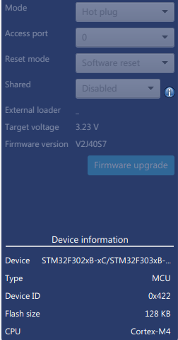

this is the bluepill-303
can you connect with stlink + Cubeprogrammer?
info:
