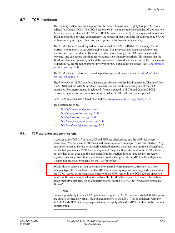

> On this chip STM32H723 one can enable caching of ITCM and DTCM.
TCM are not cached.

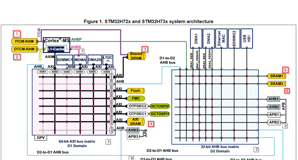

Reading AN4891, I want to know how the address space is split up from the defines in the linker file. (I am referring to the numbers I put in the screenshot)

It is clear that ITCMRAM and DTCMRAM are 1) and 2)
But RAM D1, is that 3) and 4) or just 4)
And RAM D2, is that 5) and 6)
If I interpret the information from AN4891 correctly, I will get best performance by using ITCMRAM for code, DTCMRAM for lookup tables and AXI RAM for calculation variables. Hence my question about addressing, how do I specify variables to be located in AXI RAM?
And to come back to a previous post, if I were to use the DTCM caching and want to configure the MPU, is the code I posted correct? And if I want to split DTCM into a part that is cached and part that is not, do I then specify e.g. MPU_REGION_SIZE_64KB?
And do I then split DTCMRAM in the linker file into 2 regions?

Hello everyone,
It may help to think of additional relevant information.
TCMs always behave as Non-cacheable Non-shared Normal memory, irrespective of the memory type attributes defined in the MPU for a memory region containing addresses held in the TCM. It is mentioned in ARM v7-M Architecture Reference Manual
