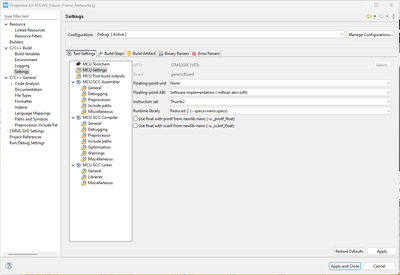

Please tell me what are the exact steps to porting the FDCAN_Classic_Frame_Networking example from the STM32G0C1VETX CPU you reference above to my STM32H735IGK6 CPU on my STM32H735G-DK board. I have tried importing the project and importing the example, creating a new project with the h735 and importing source from the G0C1, but CubeIDE still references the old STM32G0C1VETX builds files and fails.
2023-08-10 9:50 AM
I forgot to mention this..... The project properties to change the MCU type is not available.

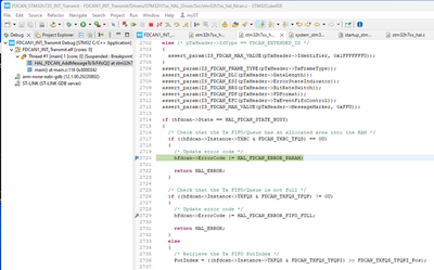

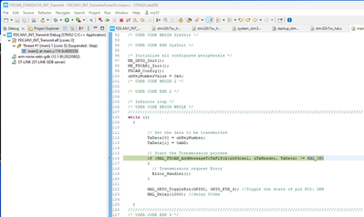

I Debug Trace all HAL functions prior to HAL_FDCAN_AddMessageToTxFifoQ, they are all HAL_OK, but
Once I enter the HAL_FDCAN_AddMessageToTxBuffer function, HAL reports a parameter incorrect error:
