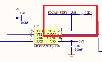

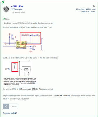

I don't see you put STDBY pin to 0 to wake the transceiver up.
There is an internal 10K pull down on the board on STBY pin:
But there is an internal Pull up on it (~33k). To me it's a bit conflicting:
So set the STBY to 0 (Transceiver_STDBY_Pin in your code).

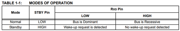

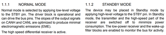

2026-04-28 7:21 AM
@mƎALLEm, the datasheet says exactly the same: STBY pin needs low state for the transceiver to be in Normal mode.

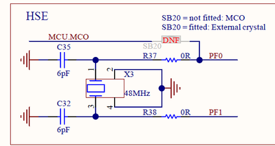

Meanwhile, you have another issue in the clock config.
You are using HSE but you set the crystal to be 40MHz while on the board the crystal is 48MHz:
It works because you are using the same board with the same software but if you connect another CAN node it won't work because there will be a mismatch in the CAN bitrate.

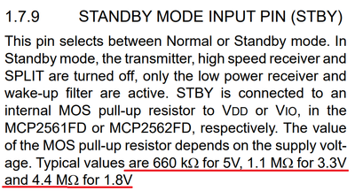

To correct myself:
The 33K pull-up resistor was on TxD pin of the tranceiver while on STDBY, the internal resistor ranges from 660K to 4.4M according to the VIO voltage.
Sorry for the wrong information.
This post will be unmarked.
