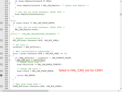

1. Two cans was used for my projects which was generated by stm32cubemx
2. after run for a short while , I turn off both cans by HAL_CAN_DeInit
3. then I reinit both cans by MX_canx_init and found it failed in HAL_CAN_Init
4. I have tried to pull both can rx and tx pins but does not work
5. Before reinit I have checked both rx and tx pins is high

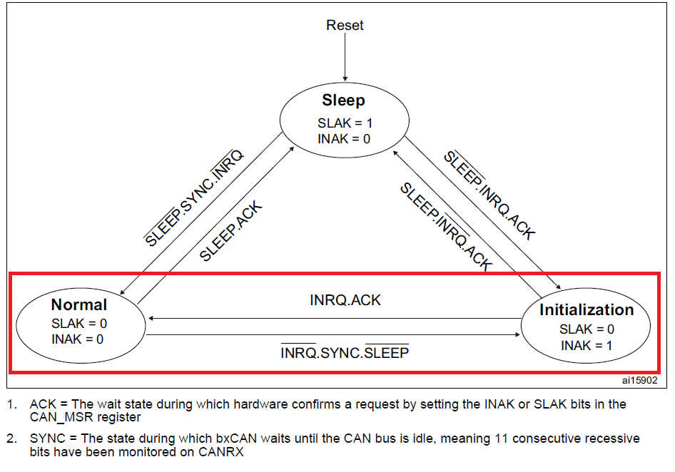

2024-07-05 12:23 AM - edited 2024-07-05 12:24 AM
As stated in the thread I gave, did you implement this requirement?:
