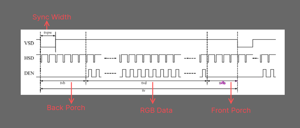

Aren't Sync and Back Porch concurrent?

Tesla and your image mean , that sync is part of accu back porch, and your nums little miss.
for example
hltdc.Init.HorizontalSync = 4;
hltdc.Init.VerticalSync = 4;
hltdc.Init.AccumulatedHBP = 12;
hltdc.Init.AccumulatedVBP = 12;
hltdc.Init.AccumulatedActiveW = 812;
hltdc.Init.AccumulatedActiveH = 492;
hltdc.Init.TotalWidth = 820;
hltdc.Init.TotalHeigh = 506;back porch here is 8 = 12-4
your nums miss
2024-05-29 10:54 AM
Concurrent in my vocabulary are "at the same time", the line totals are BP+ACTIVE+FP, not SYNC+BP+ACTIVE+FP.
If the peripheral has a single pixel counter for the line, and I'm doing a compare on that count, I hold SYNC until it hits it's count, no data goes out until it hits the ACTIVE count at BACK PORCH, and stops when it hits the FRONT PORCH
