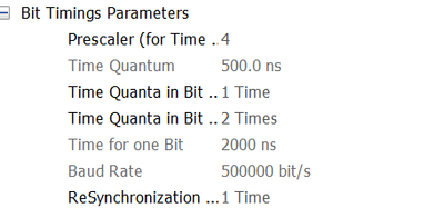

I am currently working on a Battery Management System (BMS) and an instrument cluster. I need your assistance with some issues I’m encountering while communicating between the BMS and a custom cluster board using CAN.
We have two custom cluster boards equipped with STM32F098RCT6 MCUs and TJA1042 transceivers. I successfully established communication between the two boards and received the RxData in the debug terminal.
When I attempt to establish communication between the cluster board and the BMS, no data is received in the debug terminal. Despite numerous attempts, I have been unable to achieve successful communication.
Please provide some insight about this.

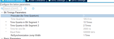

Here you didn't change anything in the timing!
And this is what I propose for your bitrate:

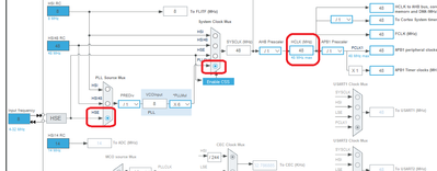

Also I'm wondering why are you using the product at 8MHz?

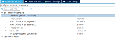

This is a config at 48MHz:
In that case I propose these timings config:
2024-10-24 9:17 PM
I adjusted the timing parameters as you recommended, but there hasn’t been any improvement.
