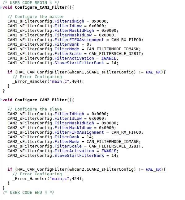

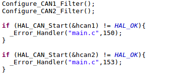

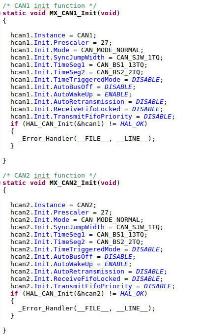

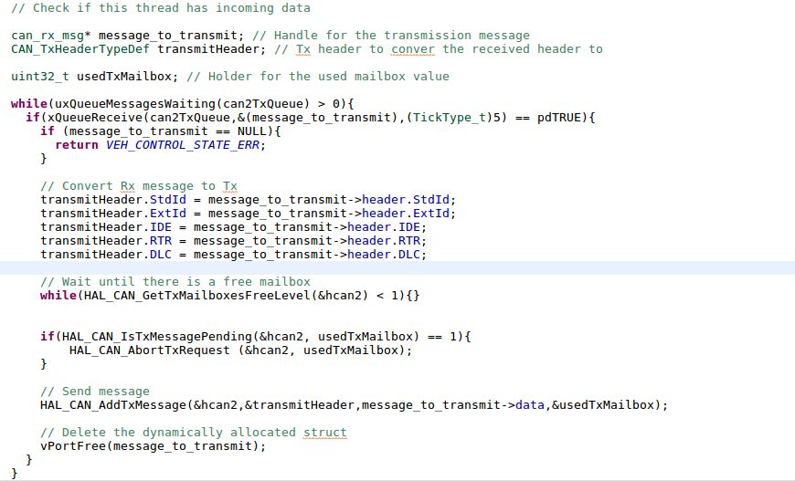

My main suspect for the issue is with CAN transmission, somewhere in between the driver (stm32f7xx_hal_can.c/.h) driver and the transmit lines leading to the ADM3054. Here is my code:In the next picture is where the code is getting stuck, the while loop that checks for a free mailbox never exits.

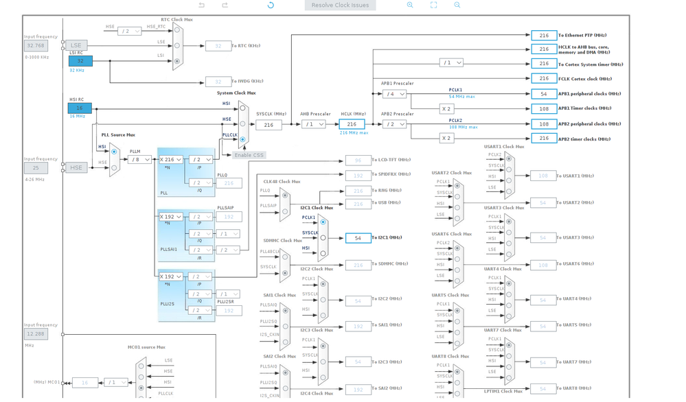

This is my Clock Config:
When in debug mode and connected to two active CAN busses, one terminating into CAN 1 and the other into CAN 2, I can confirm that I can receive messages from both busses, but I never see any transmissions. I observe that my CAN threads are getting stuck in the transmit portion of the code while waiting for the CAN mailboxes to free up. I cannot understand why the system is failing to free the mailboxes.
