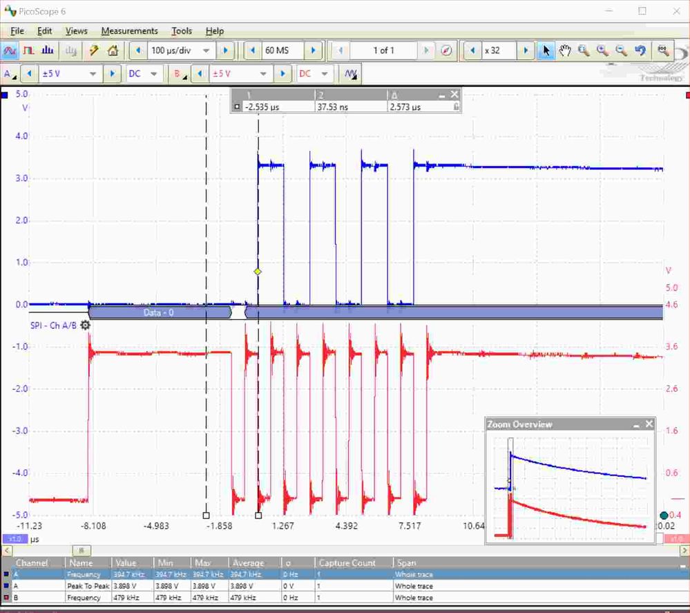

The clock and data lines on SPI seem to go tri-state off when not in use even though the SPI channel is left open. Is this expected behaviour? It causes issues with some connected chips as they see the re-establishment of the driven clock signal as a clock pulse
Code is:
HAL_SPI_TransmitReceive(&hspi3, mybufft.cTxBuffer, mybuffr.cRxBuffer, 1, 5000);
