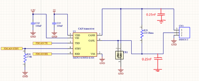

We have termination resistors at the end of the bus and I have verified that the 60 Ohm resistance is seen on the bus. I've also attached a copy of our schematic for the CANbus, which all of the nodes use (except that the 120 Ohm resistor is only populated in the two connected at the ends)

After doing extensive testing, we confirmed that the DC/AC creates a conductive noise in the CANbus (NOT irradiated noise). For conductive noise, the twisted pair and shielding on the cable made no difference for the issue we were seeing.
So we focused on filtering out the conductive noise. We added 0.25nF capacitors from CANH -> GND and CANL -> GND. When we did this, the communication is stable, even when the DC/AC is on.
We also added a common-mode choke for the CANH and CANL line, which further reduced the lossed packets in the communication. So while the capacitors were sufficient to solve the issue, the choke and capacitors combined are the full solution to our problem.
