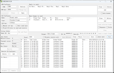

Yes, When I remove the Linux board and connect only NUCLEO-H753ZI board and USB to CAN converter, it work without any issue. Even I keep linux board then frames from STM to converter are received. The frame transmitted by STM is received on converter but not on linux board. Please note - No filter are used on any device to make sure all frame are received on all devices.
The CAN to USB converter also uses STM32F103 microcontroller. So if you can tell what CAN config used in this type of device then I can try it also
This is screenshot of can to usb converter in which I am able to recive data..
