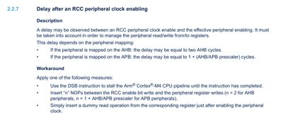

Dear @Michal Dudka ,
it might be the propagation delay of the instructions just before and the effective settings of the bits on the AHB bus . Look to this errata : https://www.st.com/resource/en/errata_sheet/es0206-stm32f427437-and-stm32f429439-device-errata-stmicroelectronics.pdf
You can insert a dummy instruction before just to explore this hypothesis. Another one is to check if you have an on-going DMA transaction waiting an acknowledgment from previous part of the code so to check and dump DMA registers as you suggested.
Hope it helps ,
STOne-32

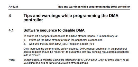

Hi @waclawek.jan @Michal Dudka
>> The dual-port DMA can get stuck, if you pull the *request* amidst an ongoing transfer. Yes I know it's not documented.
What you should do, is, disable DMA, wait until it signals its disabled (btw. that sets transfer-complete flag, too), and only after then disable the request source (here TIMx_DIER.CCxDE).
Here is a Application Note , Section 4 and further chapters
Using the STM32F2, STM32F4 and STM32F7 Series DMA controller
Let me know if it helps on the right sequence to so before disabling DMA .
Ciao
STOne-32.
2024-08-20 11:22 AM - edited 2024-08-20 11:22 AM
Hi @STOne-32 ,
1. I believe this is a core information and as such should be documented in RM, rather than as "Tips and tricks" in an AN;
2. the text says:
"To switch off a peripheral [...]"
and
"Only then can the peripheral be safely disabled".
So, it talks about "peripheral disable". For example, in context of e.g. DMA request originating in a TIM, this can be interpreted as "TIMx_CR1.CEN should be cleared only after DMA Stream has signalled it's disabled".
So that's badly formulated (it's there exactly in this form since this AN's rev.1).
The subsequent sequence ("DMA request enable bit in the peripheral control register... etc. ) suggests, that the *request enable bit* (which is clearly something different than *peripheral disable*) shall be cleared, but does not state, when. So, it can be quite well interpreted as "Clear request enable bit first, to avoid pending requests during the DMA disable process, then switch off the DMA stream, and only after that you can disable the peripheral."
Also, my post I've mentioned, talked about attempt of avoiding transfers during a certain period by disabling/reenabling the requests from the peripheral (SPI in that case); that DMA was circular and never had an intention to *disable* the DMA itself.
The problem is *not* related to DMA *disable* (even if the particular case @Michal Dudka presented here is, but that's just one particular way how the problem demonstrates itself), but most probably to the fact that the request is not properly latched in the DMA during the whole transfer, and pulling it before the transfer end results in surprising behaviour. This could be confirmed by looking at the DMA's sources.
In other words, no, this is not an adequate wording, and not an adequate place for it.
I'd suggest, in RM, in DMA transactions subchapter of DMA chapter, adding this: "While DMA Stream is enabled, disabling the request enable bit in the peripheral is prohibited and leads to undefined behaviour".
Short, concise, complete.
PS. If you are willing to improve the documentation:
- the sequence described in DMA transactions is incorrect, too
- the DMA transfer suspension subchapter is, to put it mildly, misleading. Streams can't be *suspended*, they can only be *disabled and re-enabled*, and the consequences are *very different* from what would be in case of suspended streams. That's why I experimented with disabling the *requests*.
