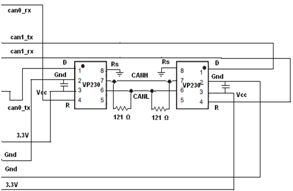

What's your external loop back look like?
2014-01-12 11:56 AM
I am using two 3.3v CAN transceiver of Texas instruments.
2014-01-16 1:21 AM
My loopback circuit look like the represented one in the atteched photo.
