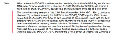

There is no auto bus off recovery on FDCAN like what was in bxCAN:
From RM0440
So you need to recover from Bus-Off by software:

2024-09-17 11:35 PM - edited 2024-09-18 1:30 AM
From RM0440

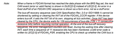

2024-09-18 1:38 AM
I think the original question has bee already answered.
But regarding your last question. I'm not sure I understood what you mean by:
@omkarprayag wrote:
how can I prevent this immediate recovery and ensure that the controller properly handles the ongoing physical issue?
Simply: before recovering from the bus-off, after detecting the bus off you do what you want to do then recover from bus off by resetting CCCR.INIT bit.
But recovering from bus off state depends on if the node detects 129 occurrences of bus idle (129x11 consecutive recessive bits). Refer to the reference manual:
