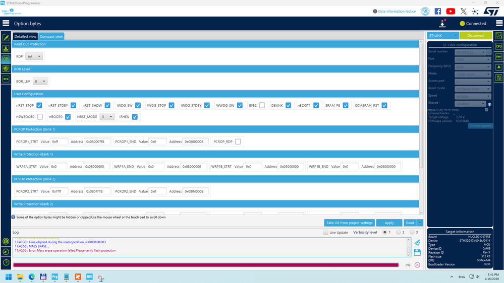

While configuring SBSFU, I modified Option Bytes, specifically Write Protection (WRP) addresses to match the SBSFU memory layout.
After applying the option bytes, the problem started.
Now I cannot program or erase the MCU anymore.

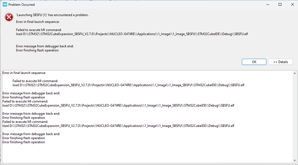

1.In STM32CubeIDE
'Launching SBSFU (1)' has encountered a problem.
Failed to execute MI command:
load ...\SBSFU.elf
Error finishing flash operation

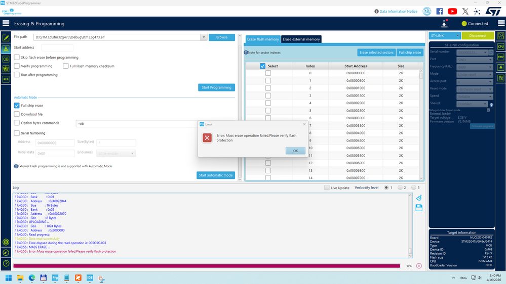

2. In STM32CubeProgrammer
Full chip erase fails
Mass erase fails with error:
Error: Mass erase operation failed. Please verify flash protection
3.I also tried:
Full chip erase
Erase selected sectors
Hardware reset / power cycle
“Under reset” connection mode
Factory reset via STM32CubeProgrammer
→ All fail with flash protection–related errors.
RDP = AA (Level 0)
PCROP and WRP were modified for SBSFU
After this change, the device seems to be locked and refuses erase/program operations

Hello @RogueOne,
I notice that WRP START and END are all set to 0.
Could you try setting up Start values to 1?
Best regards
