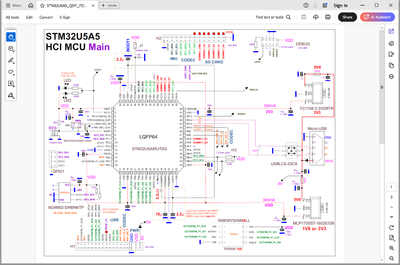

tjaekel
Lead
Yes, both VDD11 are connected together.
Just to check, that the total capacitor on VDD11 does not exceed 4.7mircoF.
(so, every VDD11 can have its own cap, but in total not above the max.)
Here my schematics:
