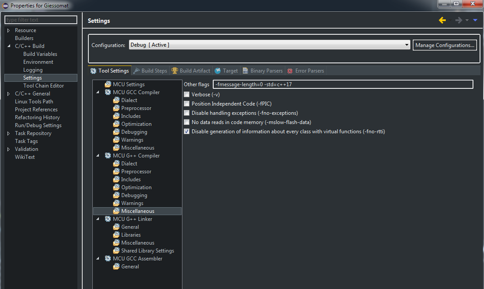

Compiler flags:
Invoking: MCU GCC Compiler
xxx\Debugarm-none-eabi-gcc -mcpu=cortex-m4 -mthumb -mfloat-abi=hard -mfpu=fpv4-sp-d16 -std=c11 '-D__weak=__attribute__((weak))' '-D__packed=__attribute__((__packed__))' -DUSE_HAL_DRIVER -DSTM32F429xx -I'xxx/Giessomat/Inc' -I'xxx/Giessomat/Inc/User' -I'xxx/Giessomat/Inc/User/debug' -I'xxx/Giessomat/Inc/User/Testcases' -I'xxx/Giessomat/Inc/User/display' -I'xxx/Giessomat/Inc/User/display/img' -I'xxx/Giessomat/Inc/User/SD' -I'xxx/Giessomat/Inc/User/SD/XML' -I'xxx/Giessomat/Drivers/STM32F4xx_HAL_Driver/Inc' -I'xxx/Giessomat/Drivers/STM32F4xx_HAL_Driver/Inc/Legacy' -I'xxx/Giessomat/Middlewares/Third_Party/FreeRTOS/Source/portable/GCC/ARM_CM4F' -I'xxx/Giessomat/Middlewares/ST/STM32_USB_Device_Library/Core/Inc' -I'xxx/Giessomat/Middlewares/ST/STemWin/Config' -I'xxx/Giessomat/Middlewares/ST/STemWin/inc' -I'xxx/Giessomat/Middlewares/ST/STM32_USB_Device_Library/Class/CustomHID/Inc' -I'xxx/Giessomat/Drivers/CMSIS/Device/ST/STM32F4xx/Include' -I'xxx/Giessomat/Middlewares/Third_Party/FatFs/src' -I'xxx/Giessomat/Middlewares/Third_Party/FreeRTOS/Source/include' -I'xxx/Giessomat/Middlewares/Third_Party/FreeRTOS/Source/CMSIS_RTOS' -I'xxx/Giessomat/Drivers/CMSIS/Include' -Og -g3 -pedantic -Wall -Wextra -fmessage-length=0 -ffunction-sections -c -fmessage-length=0 -MMD -MP -MF'Drivers/STM32F4xx_HAL_Driver/Src/stm32f4xx_ll_sdmmc.d' -MT'Drivers/STM32F4xx_HAL_Driver/Src/stm32f4xx_ll_sdmmc.o' -o 'Drivers/STM32F4xx_HAL_Driver/Src/stm32f4xx_ll_sdmmc.o' '../Drivers/STM32F4xx_HAL_Driver/Src/stm32f4xx_ll_sdmmc.c'Building file: ../Drivers/STM32F4xx_HAL_Driver/Src/stm32f4xx_ll_usb.cLinker flags:

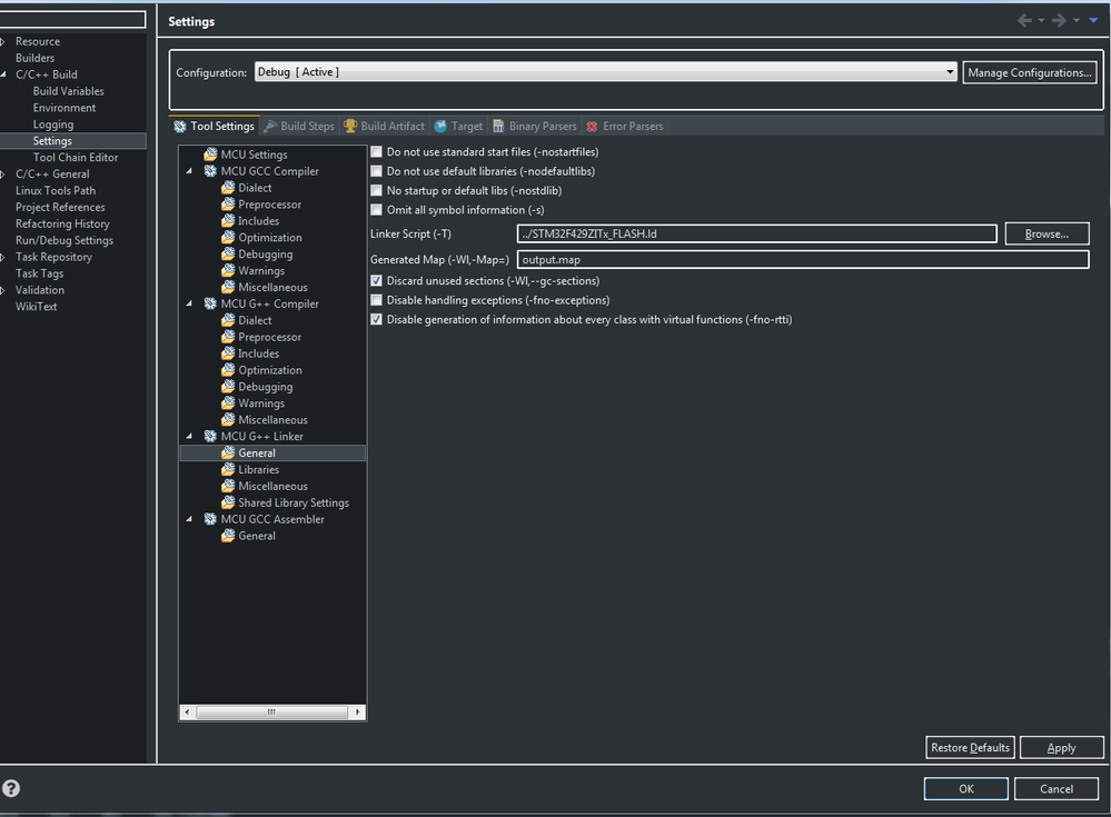

Building target: Giessomat.elf
Invoking: MCU G++ Linkerarm-none-eabi-g++ -mcpu=cortex-m4 -mthumb -mfloat-abi=hard -mfpu=fpv4-sp-d16 -L'xxx/\Giessomat\Middlewares\ST\STemWin\Lib' -specs=nosys.specs -specs=nano.specs -u_printf_float -T'../STM32F429ZITx_FLASH.ld' -Wl,-Map=output.map -Wl,--gc-sections -fno-rtti -o 'Giessomat.elf' @'objects.list' -lSTemWin540_CM4_OS_GCC -lmFinished building target: Giessomat.elfWith these flags exceptions should be enabled right? So why am i not catching this exception?

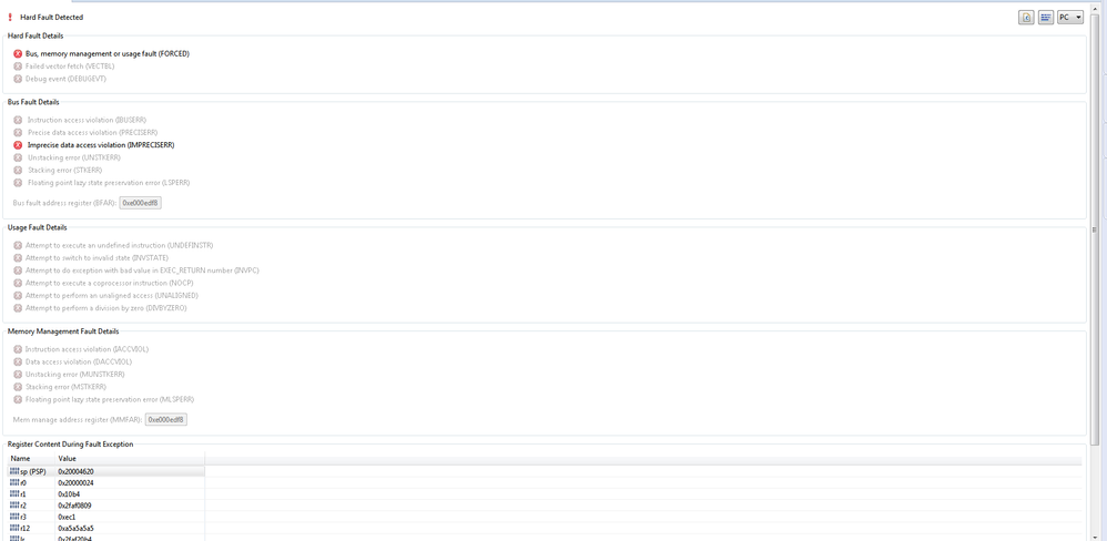

>>However I'm always running into a hard fault. I'm expecting a bad alloc exception instead.
So *what* is actually faulting? See processor registers and disassemble faulting instructions.

the faulty part is that my vector get's larger than the available free heap. The vector probably trys to allocate memory from some protected area.
How can i diagnose the hard fault further. There is no stack trace. (But I'm very sure that the vector allocation is the problem. If i reduce the number of elements added to the vector (i.e instead of 50000 only 10000) everything works fine)

I'm using gcc/g++ compiler. My settings are as followed:
Both of them have exceptions enabled.

How about instrumenting the HardFault_Handler so you get useful data?
,And adding code into _sbrk in syscalls.c or whatever is acting as the allocator. Figure out where the pool is, and how large it is.
If you can isolate where it fails you can try an unwind the call stack, or perform static analysis of the call tree.
