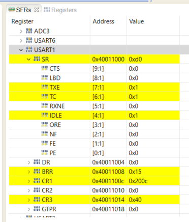

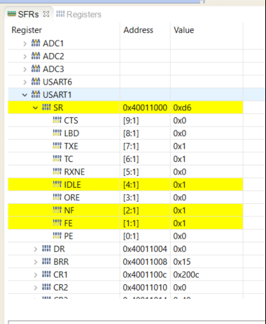

I break-pointed at the point of communication failure and sure enough both of those bits are flipped:
Breakpoint set during normal operation
Breakpoint set at point of communication failure
I'm a little baffled by this since the UART data at the pin of the MCU looks perfectly fine when we get the failure. Is something going wrong inside of the MCU?

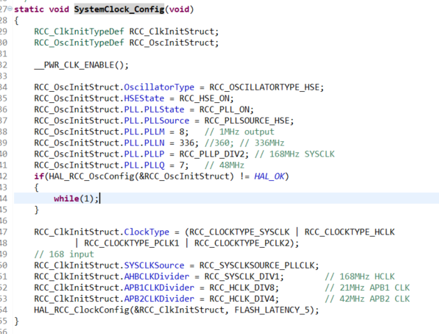

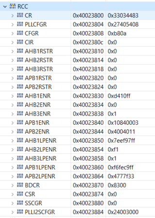

Clock setup is as follows:
There is a ton of data in RCC registers I don't know what is relevant.

RCC_CFGR.SW (and SWS) to confirm that system clock runs off PLL; all fields of RCC_PLLCFGR to confirm PLL settings, mainly that it runs off HSE (and perhaps RCC_RCC_CR.HSEON/HSERDY to confirm HSE is up and running).

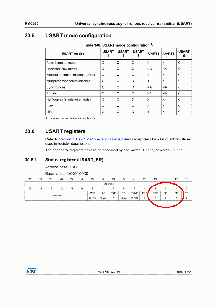

RCC_CFGR.PPRE2 to confirm that you've indeed set APB2 = AHB/4 = 42MHz. That's unusual (are you trying to spare power?). This setting also puts the baudrate divider to "strongly fractional" (not that it would be any better with 84MHz APB clock) 1.3125 (yes I should've noticed this on the USART registers' screenshot). With non-integer baudrate divisors, the requirements for precise baudrate matching become tighter. These things add up.
USART_SR.NE may (although not necessarily) also indicate that the edges are not as clean as they ought to be; you should perhaps look at them using an oscilloscope, and you should perhaps also review return/ground arrangements.

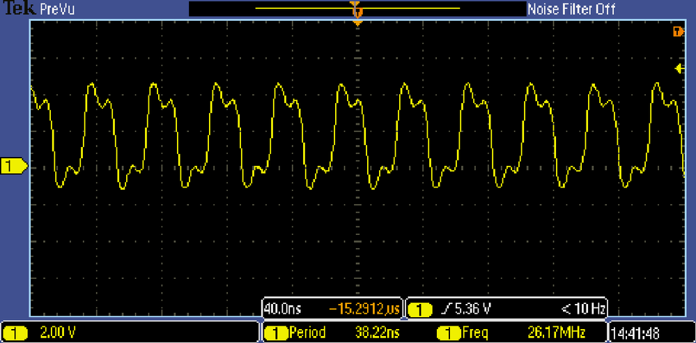

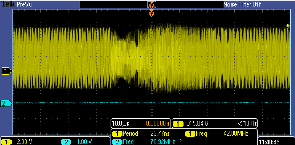

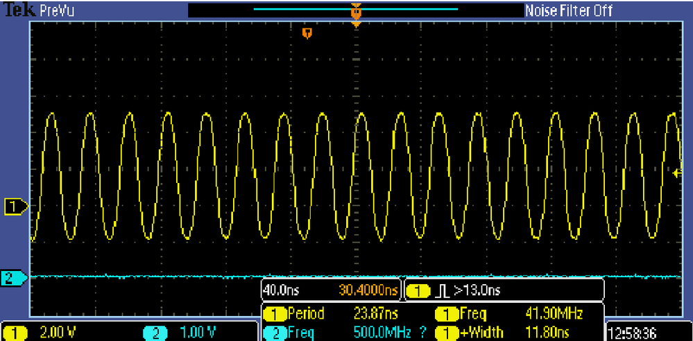

The source of the UART failure looks to be a transient on SYSCLK. I outputted SYSCLK onto MCO2 and put a scope on the pin and have been monitoring the signal. This is SYSCLK (168MHz) downscaled by 4x to 42MHz. At the point of the communication failure this is what we see
During this transient the frequency of the clock will dip down from 42MHz to as low as 20 MHz with quite a bit of noise. These transients occur anywhere from several times a minute to a few times a day.
Note that there is no device connected to MCO2 during this test, MCO2 pin is open.
Here is SYSCLK normally as seen on pin MCO2
As the glitch occurs the SYSCLK signal begins to breakdown and form this shape. It appears that there is another sinewave at about 1/3 frequency riding on the SYSCLK signal. The amplitude and frequency of SYSCLK are also changed
I’ve monitored the HSE clock on the crystal and outputted HSE on MCO1 and do not see any transients on HSE during the UART failure or this clock glitch. I also do not see any transients on the 3.3V bus during these failures. So again I am scratching my head on the cause!
