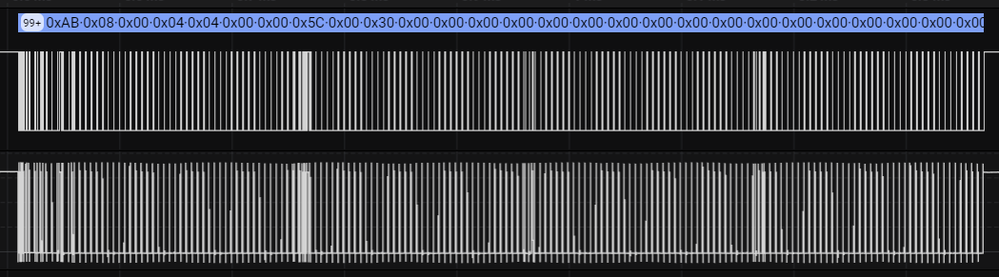

We have a packet that looks like this in the logic analyzer:
The first byte 0xAB is the packet size of 171 (actual packet size is 172 with size byte included). When this packet is read from the DMA we will get all of the same data less 1 byte somewhere in the middle.
How do you know where is the end of the packet? Is that byte missing, or just has an unexpected value?
