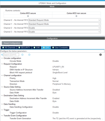

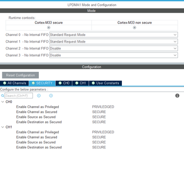

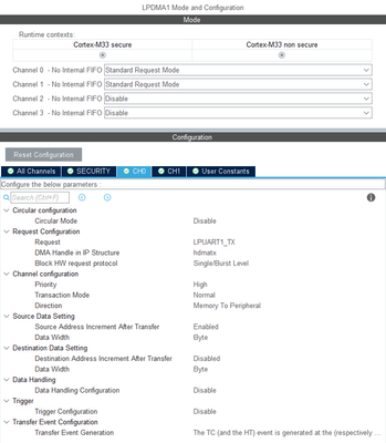

I develop a project with STM32U575 and I want to use LPUART with LPDMA, normally I use LPUART with normal DMA in my other stm32L4 projects but here I couldnt work with this peripherals. Low power is not a critical issue of this part of project. So I just want to use LPUART with LPDMA in a normal way. First picture is my old settings in L4 series and second picture ise for current U5 mcu. Do I miss something ? Where can I find and example for LPDMA and LPUART for Standart Request Mode.
