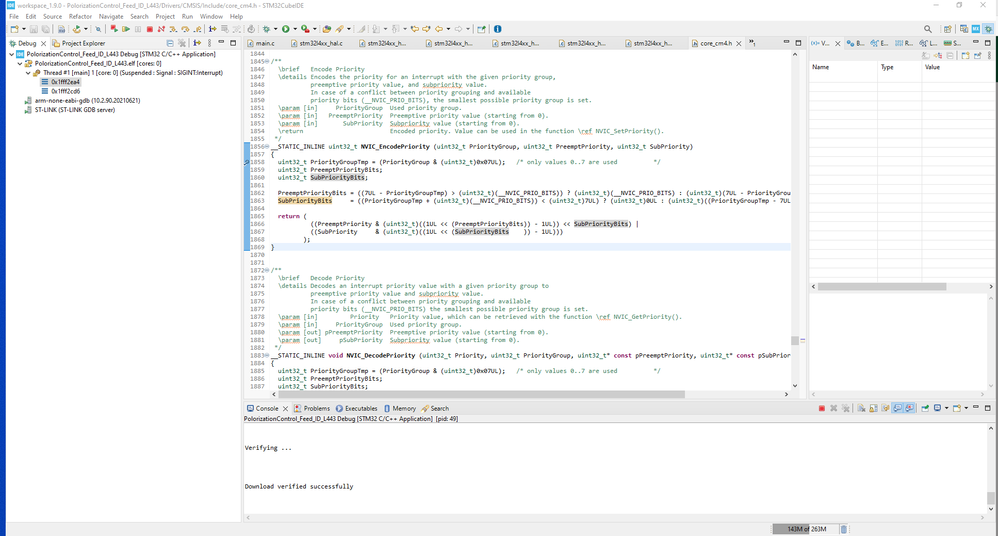

It appears to be failing on this one as soon as I single step out of the NVIC_EncodePriority inline function.

__STATIC_INLINE uint32_t NVIC_EncodePriority (uint32_t PriorityGroup, uint32_t PreemptPriority, uint32_t SubPriority)
uint32_t PriorityGroupTmp = (PriorityGroup & (uint32_t)0x07UL); /* only values 0..7 are used */
uint32_t PreemptPriorityBits;
uint32_t SubPriorityBits;
PreemptPriorityBits = ((7UL - PriorityGroupTmp) > (uint32_t)(__NVIC_PRIO_BITS)) ? (uint32_t)(__NVIC_PRIO_BITS) : (uint32_t)(7UL - PriorityGroupTmp);
SubPriorityBits = ((PriorityGroupTmp + (uint32_t)(__NVIC_PRIO_BITS)) < (uint32_t)7UL) ? (uint32_t)0UL : (uint32_t)((PriorityGroupTmp - 7UL) + (uint32_t)(__NVIC_PRIO_BITS));
return (
((PreemptPriority & (uint32_t)((1UL << (PreemptPriorityBits)) - 1UL)) << SubPriorityBits) |
((SubPriority & (uint32_t)((1UL << (SubPriorityBits )) - 1UL)))
}It comes in with PriorityGroup = 3
PreemptPriority = 0
SubPriority = 0
It creates:
PriorityGroupTmp = 3
PreemptPriorityBits = 4
SubPriorityBits = 0
When I exit this routine with a single step, the debugger stops working. The only thing I can do is Terminate.
If I suspend it says 0x1fff2ea4 but I do not know how to interpret that,
Are there any ideas where I should look to get this working?
