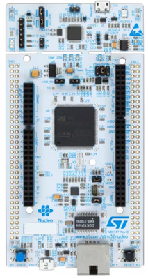

The board is not custom, it´s the eval board STM32F767 from the link above.
I have bought it in 2022.

yes, this looks very similar. I just looked it up:
Board Model is: Nucleo-F767ZI.
MCU is STM32F767ZIT6U
Yes it's the Nucleo-F767ZI. It's a Nucleo board not an Eval board.

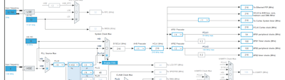

Ok I don't see an issue in your system clock config. Doing the exercise in CubeMx:
It looks good.
