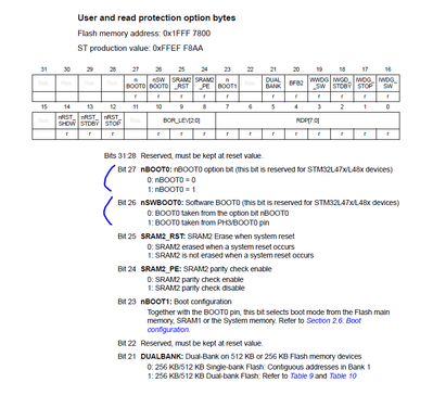

If I well understand your question, you want to boot from system memory. to do this you have to follow the configuration as below :
You have the possibility to use nBoot0 bit instead of Boot0 pin in the option byte area :

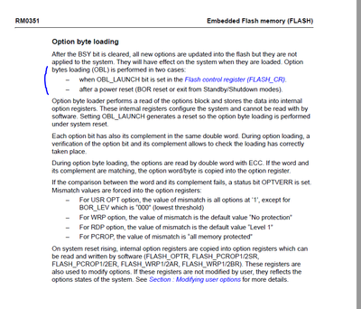

The first time you have to use OBL_Launch to force the option byte reloading :

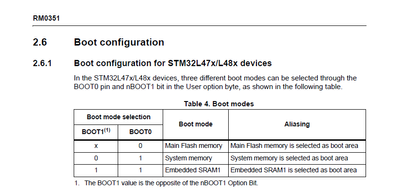

An important point to note is this :
So I recommend you to read the reference manual of your device. Here below STM32l4x :
