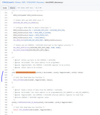

hello @Chris_student
You could find what you want here (function definition):
https://github.com/STMicroelectronics/STM32CubeF4/blob/master/Drivers/BSP/STM32F401-Discovery/stm32f401_discovery.c
As you are using F4 devices, you could find information into the F4 discovery board BSP.
Best regards
Mikael

I did but it did not work, i added these 3 libs because they are needed and made sure the path was right but it wont work. when i open the declaration of COMPASSACCELERO_IO_WRITE i get passed to the .h file so thats good but i can not find the function it self enywhere. because as far as i know there should be a function of COMPASSACCELERO_IO_WRITE with code in it. But this is no where to be found.
(COMPASSACCELERO_IO_WRITE is a function that gets called by multiple functions in the .c file)
Best regards
Mikael
If you feel a post has answered your question, please click Accept as Solution.
I see i am missing some of the basic libs that come with the discovery board thanks a lot!
