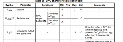

Are you sure the DAC1 is not disturbed externally by that "data logger"?
Are you sure the data logger impedance value is inline with the specification?:
If you disconnect the data logger are you seeing DAC1 getting back to a normal operation?
Try to add a voltage follower on DAC1 output to adapt the impedance.
