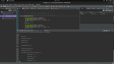

Okay, So I tried debugging the code with debugger. I'm able to see that the if statement is not satisifed. I'm new to STM32 and I'm not sure how to print the values on debugger console. Can anyone please help me with that? Also, check the image for reference:

Well, my question is how to make the uart code work as I'm not sure what am I missing. I'm using Nucleo-H723ZG (with genuine ST-LINK on-board) to debug the code as I don't have sepate debugger to test on black pill. So, how can I print the variables in the debugger console while using the st-link onboard?
Two ways. (But none of them prints to the debugger console window like on your screenshot).
1. The onboard ST-LINK usually has internal USB to serial adapter, so called "VCP". On the STM32 side it is connected to one of U(S)ARTs. See your Nucleo user guide to know which UART it is, on which pins.
Then just initialize this UART in "asynchronous mode" and send your output. On the PC side use your favorite terminal program such as Teraterm. CubeIDE also has a serial terminal built in, but IMHO it is less convenient.
2. The onboard ST-LINK can use STM32 feature called ITM. It is basically a sub-channel of the debugger connection that you can use to send output. You need to enable it in the debugger options. The output will go to a special window of CubeIDE or other debugger: "ITM console" or whatever. Like the former, this does not need a separate cable, just the debugger USB cable plugged in. Very convenient.
Please take your time, check the examples, CubeIDE user manual, ST app. notes and your favorite search engine.
