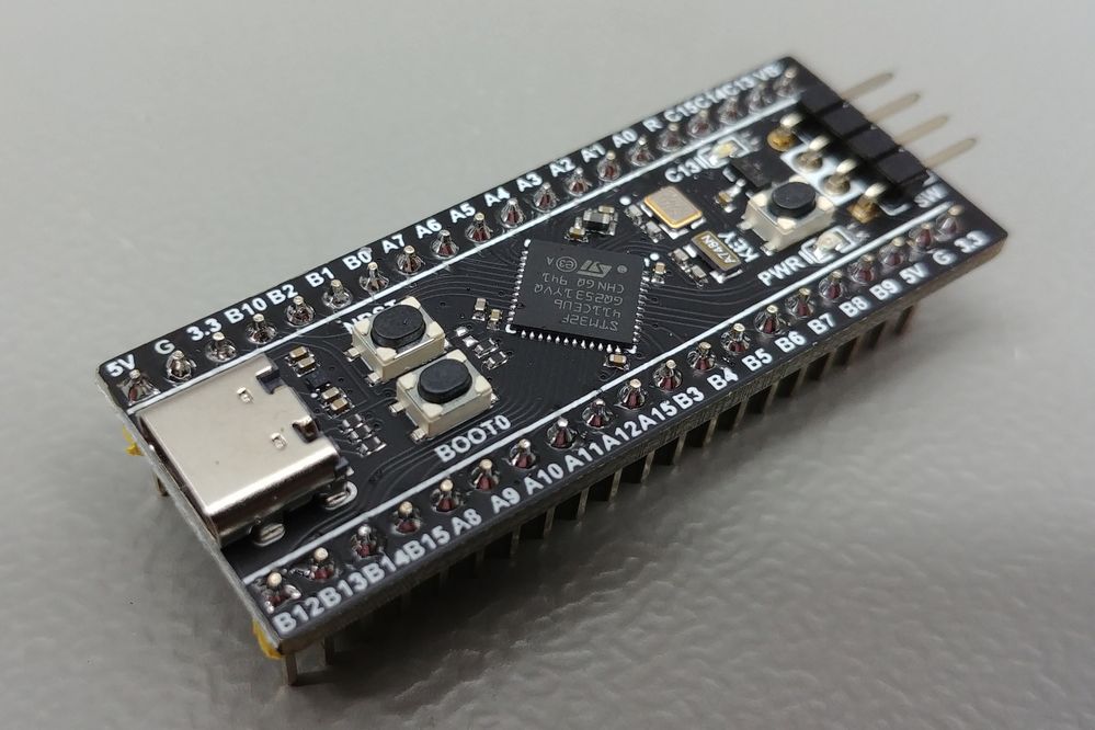

Also, The board I'm using currently is this:
So, When I run the above code. The corresponding GPIO is not responding. Kindly help. Thanks in advance!

2024-09-06 11:24 AM
You have:
HAL_GPIO_WritePin(GPIOC, GPIO_PIN_13, 0);
in all cases, it is never set high.
