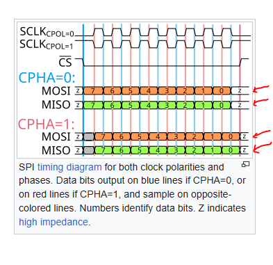

The Wiki page suggests data lines are tristate (floating) when inactive:
https://en.wikipedia.org/wiki/Serial_Peripheral_Interface

While I haven't found an explicit statement in the reference manual, it seems the "Z" state (tristate/floating) is standard for this unused pins. If glitches originating from nearby data lines are visible, it means no side is driving this line, and it shouldn't be a problem.
