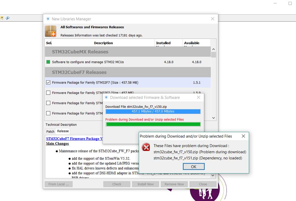

Thanks for replying. I have updated my STMCubeMX to Version 4.18.0. I have deleted my previous STM32F7 firmware repository as I wanted to start fresh. I setup a STM32F7x9 project and selected the right MCU. In project settings, I entered name, selected SW4STM32 tool chain and clicked on. Since the firmware repository was missing, I went into Help->Install new libraries which opened the library manager there I selected Firmware Package for Family STM32F7 1.5.1 and clicked Install now. I got this error.
The first thing I noticed is even though I selected 1.5.1, it downloaded 1.5.0(dependency maybe). It failed. I also tried to install 1.5.0 first prior to 1.5.1, it failed too. I manually visited this link
and download the latest FW 1.6.0. Surprisingly the latest version shown in cubeMX software is not the same as that listed on site. Anyways, I downloaded it and unzipped it to the repository folder on my PC. In the project settings, I selected that FW package path and clicked generate code. So far so good.

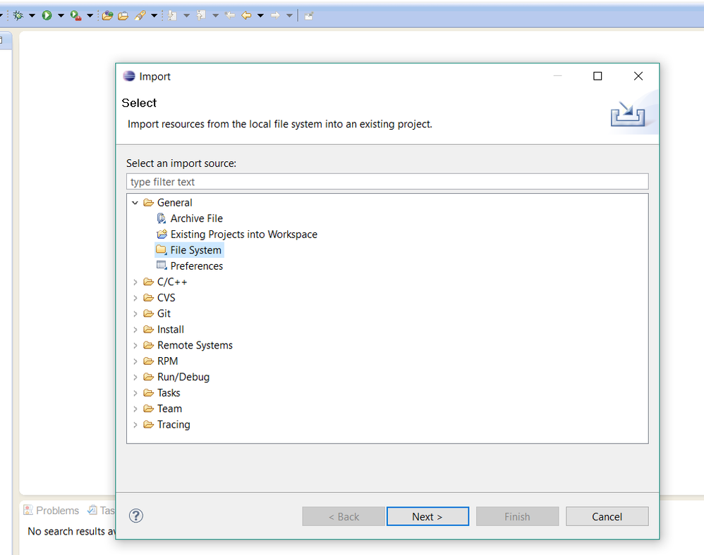

I am using windows 10. I have eclipse Kepler installed. When I click Import, I don't get Projects from folder or archive, I have something like this:

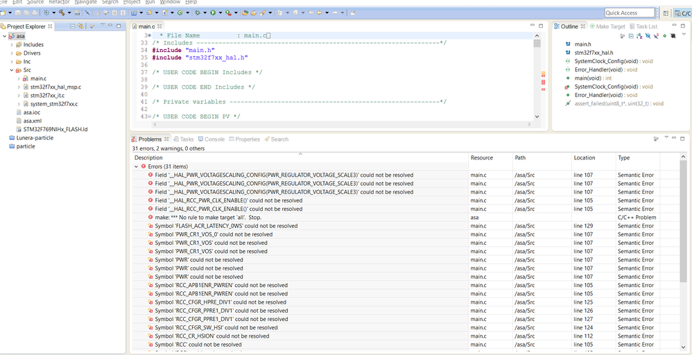

I selected C/C++ and imported it as MakeFile project and selected Ac6 STM32 MCU GCC toolchain(this showed up after I installed the eclipse plugins). I get the following errors in my eclipse console. When I click build it says,
No rule to make target all. I didn't find any makefile in the repository. How will the project build?

About the firmware dependency, you are absolutely right. The version 1.5.1 is an update of the 1.5.0. So to be able to install it, the system needs the 1.5.0 to be installed first.
About the firmware instalation issue, it looks that something goes wrong during the download... I report this internaly.

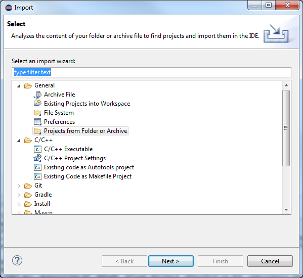

About the import project, here is what I get:
I searched under Eclipse project and found the following news:
http://www.eclipse.org/eclipse/news/4.6/M7/
It looks the menu I am using is new from version Neon.
I tried using ''Existing Project into Workspace'' , and it works well.
Could you try that way too ?

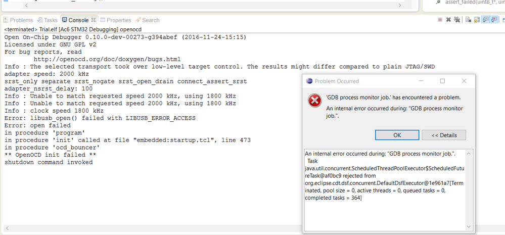

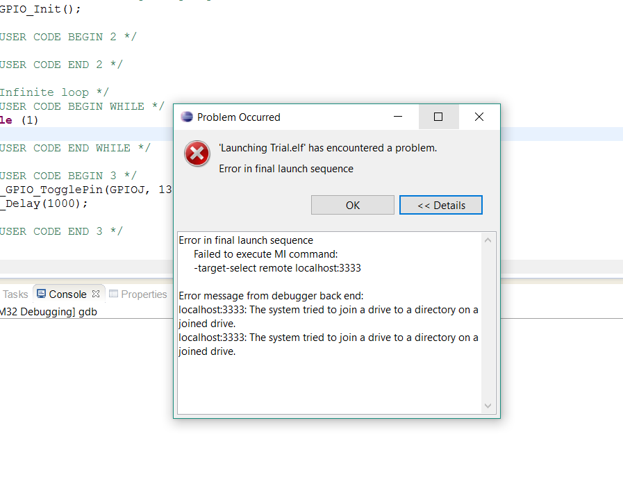

Thanks for the reply. I did import as ''Existing Project into workspace'' and the build succeeded without any errors. Awesome! But I have another problem now which I didn't have it before. When I press debug, I am getting these error messages:
The first message, ''the system tried to join a drive to a directory on a joined drive'', is because when I plug in my STM32F769-disco board, it shows as a 2 MB removable storage on my computer. It has 2 files in it, DETAILS.txt and mbed.htm. It didn't show up as a removable storage media before. Strange. The first error is due to this. I am not sure about the second error. I didn't change any clock settings in cubeMX.
After I press the debug button, the COM LED stays green all the time instead of flashing red and green. I had no luck running a blinky sketch on this. I appreciate your help and I'll try to reply fast from now onwards. Any ideas on these errors?

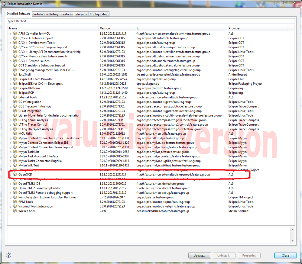

Hello Dheeraj,
When the board connect to USB, it registers with several profile. One of them is USB Mass Storage. This is normal for the demo boards.
About your error message, it looks openOCD failed to connect to the board -> libusb failure
First could you be sure to have installed the two following windows drivers :
They are needed for respectively firmware upgrade and support board communication over USB.
Then could you check the openOCD Eclipse version ?
Mine is 1.12 as in the attache picture.
Let me know before moving deeper :)
KR
