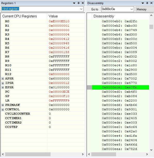

Main app is usually busy with talking via CANBUS, reading/writing data via I2C-SPI-SMBUS, and does some periodic jobs triggered by RTC wake up. Whole system works well for a while(sometimes 1 hour, sometimes 4-5 hours), than suddenly communication with CANBUS is breaked down. When I pause debugging I see that PC is at 0x80025c6: 0xe7fe B.N in dissassembly section. As I research 0xe7fe stands for infinite loop, and it seems to be in Bootloader section.
When I debug with Bootloader code and same error happened, I see PC is at RTC_IRQ_Handler which is at 0x80025c6. Despite RTC is not enabled at Bootloader, Main App is jumped to bootloader's interrupt location(or it can be complately different issue)

All of the unused irq handlers get mapped to the same infinite loop default handler by default. You can look at VECTACTIVE bits in SCB->ICSR to figure out which IRQ is active, if any. Doesn't seem like it should be jumping to a handler outside of your application, but maybe that will shed some light.

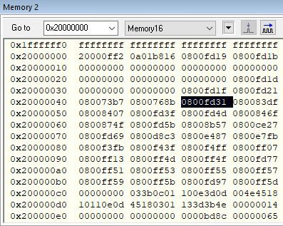

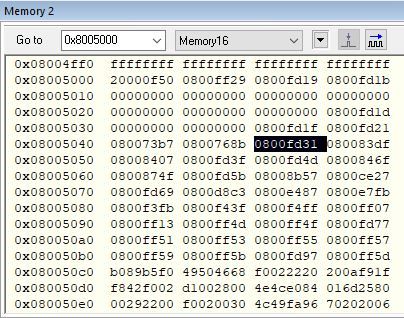

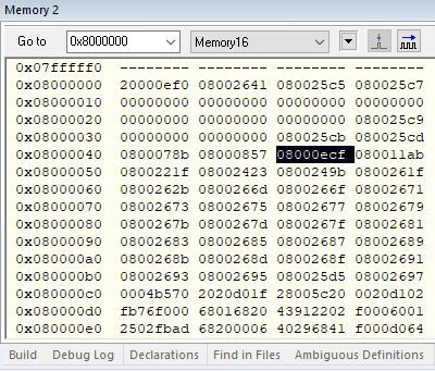

I will share content of vector tables placed in different memory locations.
Vector Table of Bootloader at 0x08000000
Vector Table of Main App at 0x08005000
Vector Table Relocated to Sram at 0x20000000

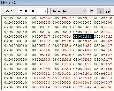

Vector Table at Remapped Address at 0x00000000 while system working properly.

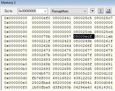

When we get same error which is stucking at 0x08000ECE Vector table is as seen below
The black selection in secreenshots shows RTC Irq handler addresses of RTC peripheral. It seems while main app is running properly, suddenly vector table is mapped to flash, and PC is jumped to Bootloader's RTC Irq handler address. Have you experienced similar issue before?

2020-11-23 8:59 AM
I'd assume some sleep/standby code that causes the chip to reset the mapping.
Best to disassemble the code and look at what's actually built in there.
Instrument the code so you have some idea of flow and interaction causing this to occur.
