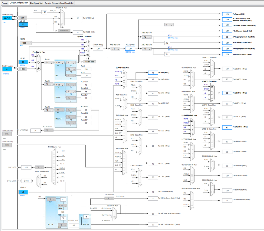

Hi @jeffry159 ,
You're using the HSE oscillator as a clock source. However, on the Nucleo 144 board, the crystal is not provided.
You may use the HSI or MSI instead.
Khouloud.

Pay attention to the clock configuration. I suspect that's the cause of the issue.
You're using STM32CubeMX, you may share a screenshot of the "clock configuration" window.
Khouloud.
2018-08-24 12:38 PM
Here is my clock configuration window.
It seems there are some differences, not sure what is each branch means yet. So should I try modifing the clock setting inside STM32CubeMX with working code as guide or is there any other way to set it "right" ?
