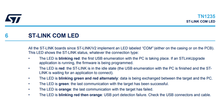

About LD4 on Nucleo-H753ZI, it's called "ST-LINK COM LED". you may find details information about this LED function in TN1235.
Attached below also a capture of key information. thanks!
