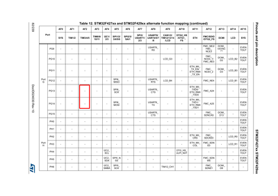

PG13 and PG14 are not TIM4_CH1 and TIM4_CH2.
