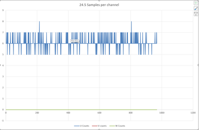

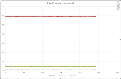

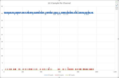

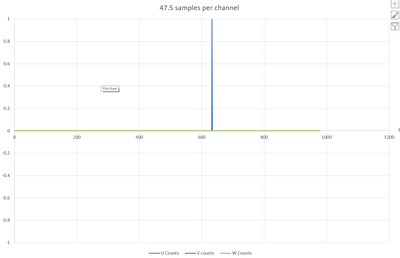

HiI've noticed unexpected behaviour with the ADCs on the STM32G474RE.The behaviour I have found, is that voltage from one channel can bleed onto the next sampled channel .eg  if channel 1 has a high voltage, and channel 2 is at 0V, I see a large ADC ...
lliwdliw_0-1689856914151.png lliwdliw_1-1689856946072.png lliwdliw_2-1689856977926.png lliwdliw_3-1689857004318.png
