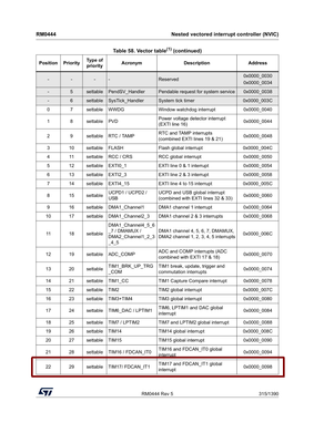

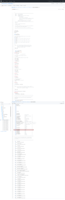

It's screenshot of the startup code, clicking on it it will bring you to the highlighted line, which is the item in vector table - you are supposed to write an ISR with that name.

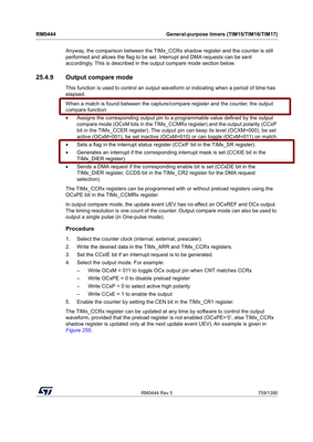

You can find more information on this in RM0454 if needed.

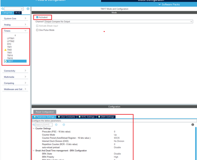

In CubeMx it looks like this:
You choose your timer in question on the left and you activate it.
In the NVIC Settings tab, the global interrupt should be activated:
This checkbox will create your callback in the stm32g0xx_it.c file.
